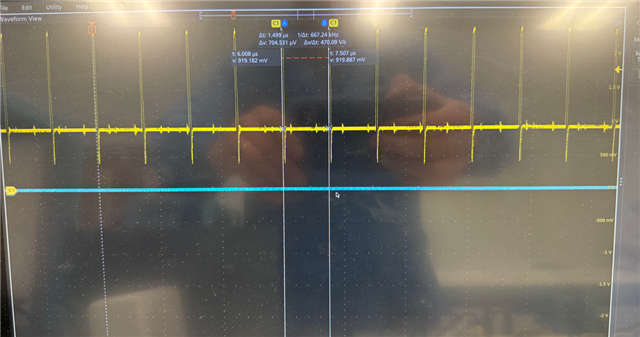

We observe bizarre behavior with LMX1860-SEP. As soon as the SYSREF_EN pin is asserted hi, the device outputs pulses to VCC on its SYSREF output channels. The pulses are not valid LVDS or CML pulses -- the two polarities (P & N) move together, rather than complimentarily (see scope shot). This is before any SPI Configuration whatsoever. Furthermore, the device will do this without a valid clock signal on clk_in P / N. To make matters worse, the device seems to not accept any SPI configuration with SYSREF_EN asserted hi. We have probed VCC --  it is stable at 2.5V. Our logic signals (SYSREF, MUXOUT_SEL, etc) are all 1.8V logic.

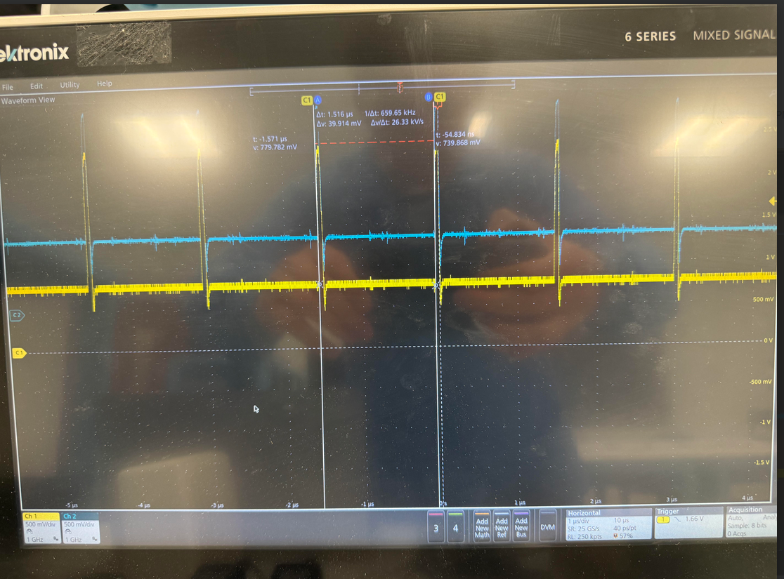

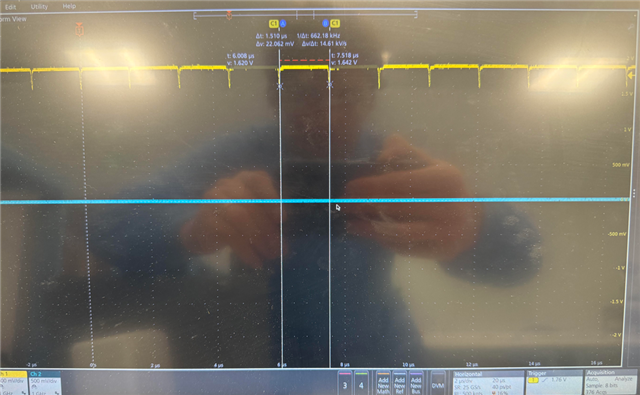

    7. Observe common mode pulses on LOGICSYSREF and SYSREFOUT0. Pulses also appear on disabled SYSREFOUT channels, but they look different.

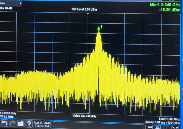

    Also note the RF output (RFOUT0) is apparently modulated by the ~660 kHz pulse train.
    SYSREFOUT0 (enabled)
    SYSREFOUT1 (disabled)
    LOGICSYSREFOUT
