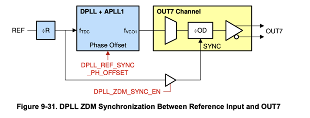

Please provide guidance on the following functionality:
LMK05318B Data Sheet
Section 8.3.16: 1PPS Input-to-Output Phase Alignment (PRIREF-to-OUT7 SYNC)
As an initial step, we configure the device as follows:
 - R252[7] DPLL_REF_SYNC_OUT7_EN = 0b1
 - R340 to R345 DPLL_REF_SYNC_PH_OFFSET = 0x0
We then perform a PLL reset using the following sequence:
 - R12[7] RESET_SW = 0b1
 - Wait 1 second
 - R12[7] RESET_SW = 0b0
We expect the OUT7 1PPS signal to be aligned with the PRIREF 1PPS signal within a few nanoseconds. However, the phase difference between PRIREF 1PPS and OUT7 1PPS is approximately -200 µs to -500 µs.
Immediately after the software reset is released, the first pulse has a phase difference of within +10 ns. However, it appears that the phase difference becomes significantly larger at some point afterward.
The phase difference changes to either approximately -200 µs or -500 µs each time a software reset is performed. Once it settles, however, it remains fixed at either -200 µs or -500 µs; it does not continuously vary between these values.
This behavior appears to indicate that the PLL locks after adjusting some kind of offset phase.
Could you please explain why the device behaves this way?
Also, please advise us which parameters need to be configured in order to achieve the expected phase alignment.
T.Serizawa
    Can you also try to set DPLL_REF_SYNC_OUT7_NDIV_RST_DIS = 1 and see if that improves the device behavior? Usually for 1pps phase alignment we recommend having this bit set along with DPLL_REF_SYNC_OUT7_EN.

    I tried adding the setting DPLL_REF_SYNC_OUT7_NDIV_RST_DIS = 1 while leaving the other parameters unchanged, but this did not improve the operation. Are there any other parameters that need to be configured?
    As mentioned previously, the phase difference immediately after releasing SW_RESET is limited to approximately +10 ns. We expect this phase relationship to be maintained. Is it possible that an OFFSET value is being applied unintentionally?
    Additionally, we measured the unintended phase difference using multiple DUTs and observed different values for each DUT. From a circuit-design perspective, are there any factors that could affect the phase offset?
    As a supplementary note, I should have clarified that a GNSS-referenced 1PPS signal is being input to PRIREF. We are checking the phase against an external reference signal, and since the phase variation during the test is only a few nanoseconds, we believe that the stability of PRIREF is sufficient.
  • Hi Serizawa,
    Since the initial phase error is only around 10ns and the steady state phase error is much wider, I wonder if it's possible that the DPLL is not locking properly. Can you try the debug steps below and see if any of these help?
    • Monitor the DPLL LOFL and LOPL status to confirm that the DPLL is reporting lock
    • Monitor the value of PLL1_NUM_STAT during DPLL lock acquisition. Ideally this value should be reasonably close to PLL1_NUM. This will essentially provide information on the measured frequency delta between the XO input and 1pps input
    • Set R303[0] = 0. This can sometimes help improve the lock behavior for low frequency inputs (<2kHz)
    • Readback R345 to R340 to confirm that no phase offset value is being applied
    My expectation is that with 1pps input-to-output alignment enabled and a phase offset of 0, the steady state error should only be a few ns and there should not be too much variance from device to device.
  • Thank you for your response.
    - `LOFL` and `LOPL` indicate that the DPLL is locked.
    - We observed a difference between `PLL1_NUM_STAT` and `PLL1_NUM`.
    - `R303[0] = 0` has already been configured, but we have not observed any improvement in the issue.
    - `R340` through `R345` are set to 0.
    Although this is different from the behavior suggested in your comments, we reconfigured the `OUT7 DIV` using TICS Pro, after which the 1PPS phase difference settled at approximately −26 µs.
    However, the issue that different phase differences are observed for each DUT has not been resolved.
    We have attached the register readback results obtained while maintaining the phase difference of approximately −26 µs. Could you please review them?
    The registers were read twice: once immediately after recovery from `SW_RESET`, and again five minutes later.

  • Hi Serizawa,
    The sequence for softreset you mentioned is correct and complete.
    About the phase differences observed between devices or between power cycles.
    Try R252[7:6] = 0x03
    The LMK05318B has support for pseudo Zero Delay Mode ZDM by resetting the output divider, it is not a feedback from the OUT7.
    Output phase will be deterministic within one VCO cycle and OUT7 must be derived from DPLL + APLL1.
    If this phase deviation is still too high I would suggest the LMK5B33216 device series.
    For best phase lock behavior on 1 PPS, manually set R303[7:0] = 0x00 as you will find 0x01 in the TICS Pro output (HexRegisterValues file).

  • Dear hidetaka,
    Maybe your XO frequency is drifting during first minutes.
    Do you use an OCXO?
    I was able to reproduce similar behavior.
    Custom board, LMK05318B,  XO=24.576MHz OCXO, 1PPS reference.
    First PPS pulse at out7 within about 10's of ns.
    Second and following PPS pulses with 67.2 ms offset. Solid at 67.2ms. DPLL freq+phase locked.
    How to reproduce at least 5 times:
    Custom board (hot OCXO) power interrupted for 30 seconds to let the OCXO cool down several degrees.
    PPS from GNSS continues with standby-power.
    My thoughts:
    After PRIREF validation the out7 unmuted and out7 divider is reset by the PRIREF pulse to get deterministic phase.
    The OCXO output frequency is not stable within the short ref validation period of 6.4 seconds. Still heating up.
    I believe that the (quasi) ZDM captures the PPS while rising/falling XO frequency.
    The LMK05318B has a ZDM implementation that works under certain conditions.
    With hot OCXO the phase was repeatable in the <50ns range.
    A controller soft-resets the LMK05318B after reaching stable working temperature or 5 minutes timeout period.
    Octo
