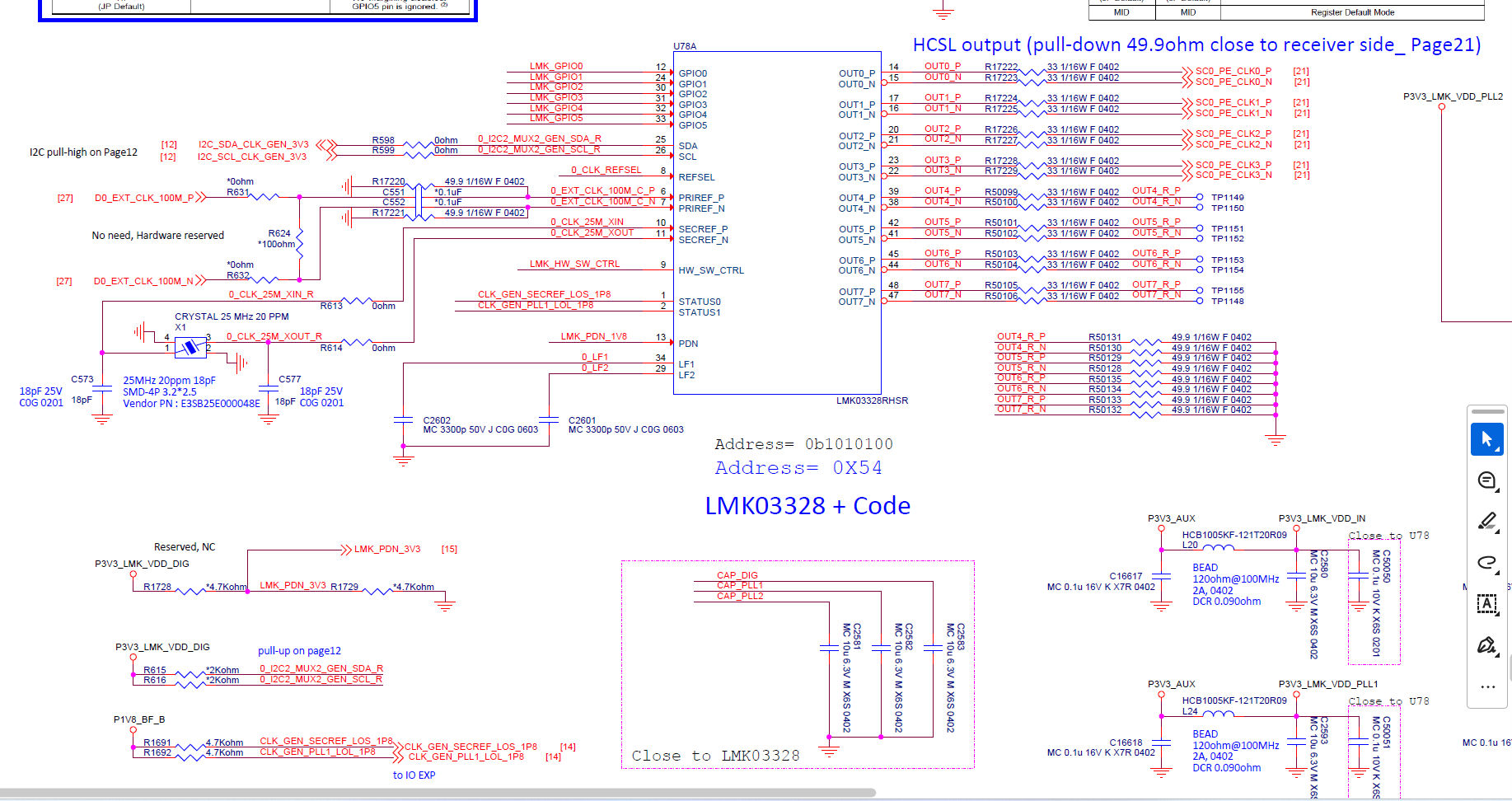

Here is our LMK03328 schematic.
And the LMK03328 config file as attach. AWS NPO-Test-Platform LMK03328 profile.zip
We are seeing an unexpected SECREF_LOS indication on LMK03328's STATUS0 pin when SECREF is configured as a 25 MHz XTAL input.
Current observations:
* 25 MHz XTAL is oscillating normally (~1.8 Vpp)
* PLL1 is locked. We confirmed this by measuring LMK03328's STATUS1 pin, it is ~0V  which means PLL1_LOL is deasserted.
* All 100 MHz outputs of LMK03328 are normal
* However, we see LMK03328's STATUS0 pin is ~1.8V which means that SECREF_LOS is asserted.
* We tested all SECREF detection modes (VIH/VIL, + Slew, - Slew, +/- Slew), but SECREF_LOS remains asserted.
Could you please confirm whether SECREF_LOS is supported in XTAL Input mode? If yes, is there any specific detector/register setting required for XTAL mode?
