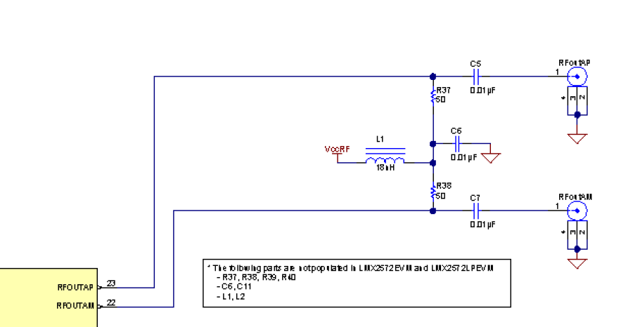

LMX2595EVM: Inductor pullup
Part Number: LMX2595EVM
Other Parts Discussed in Thread: LMX2595
I'm testing the LMX2595 PLL evaluation board. By default the output pins pull-up is with a 50 Ohm resistor. I need to measure the maximum output power of the PLL with the inductor-type pull-up. How do I need to modify the evaluation board to do that ? Could I just substitute the 50 Ohm resistors with the inductors ?
