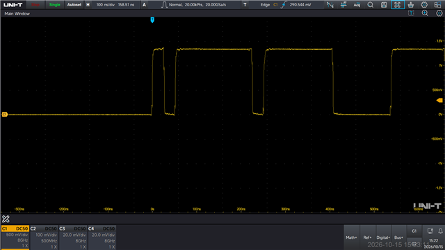

    After I attempted to write it, the resulting signal was a bit abnormal. After passing through the intermediate state, the signal eventually disappeared, which did not match the expected 10 MHz signal. The input was a 25 MHz square wave generated by the AWG, and it was observed using a scope as shown in the figure. The program involves writing to R85 to R0, and then calibrating by writing to R0[4]. Have I overlooked any steps?
    Linli
  • Hi Linli,
    Could you describe a bit more what exactly you are measuring, and what signal is looking abnormal? Is this your reference into the CDCE6214, or is this the output? If the input is too noisy the device might not be locking to the reference; you can read back register R7[0] to determine if the PLL is locked to the reference or not.
    Jaryd
