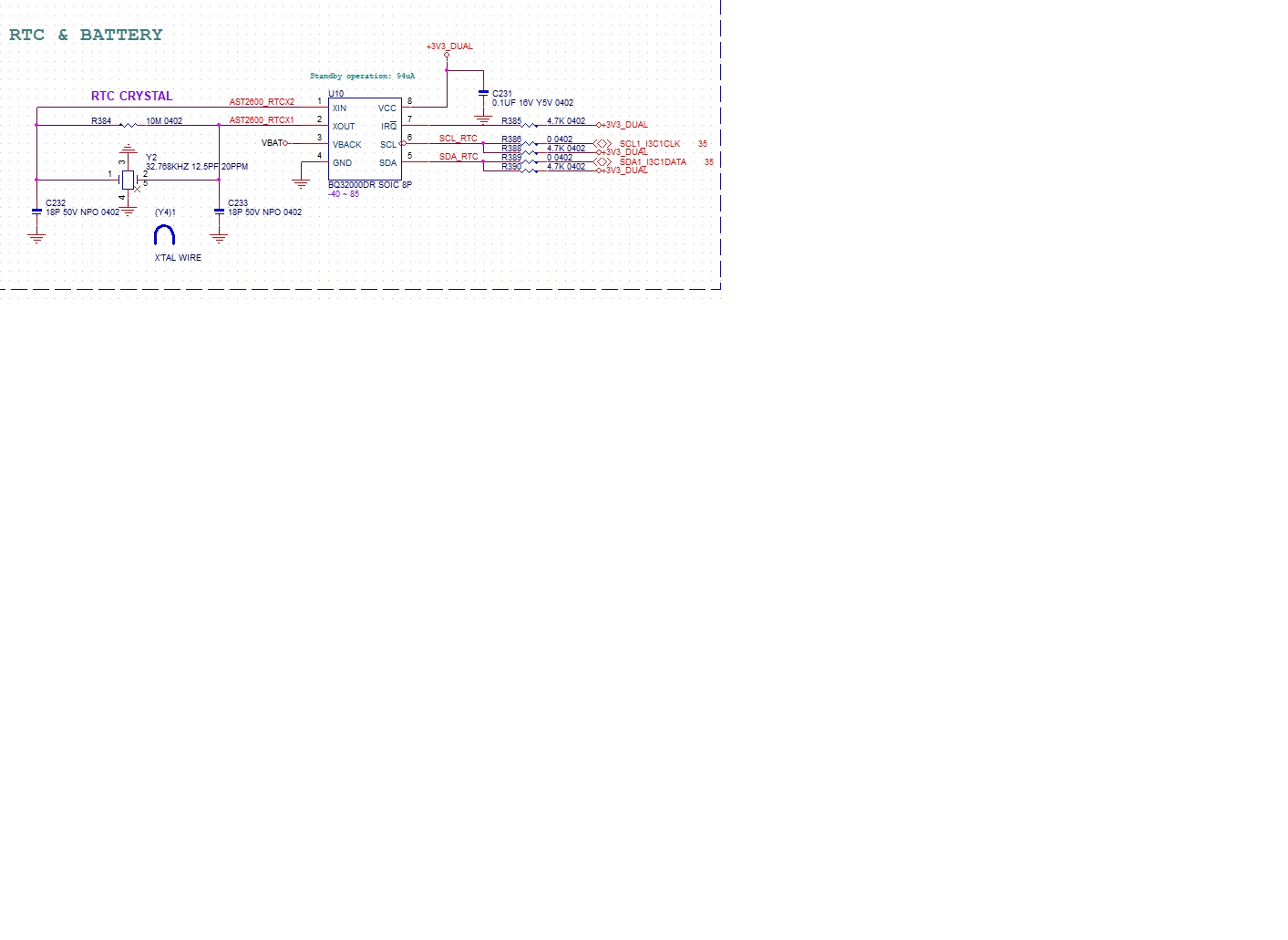

I would like to ask about the BQ32000DR. Are any external resistors or capacitors required for the XIN and XOUT pins?
Thanks!
Hi There,
No external loading capacitors and feedback resistor is required as long as your crystal meets datasheet requirement.
