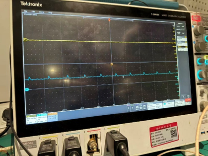

1. When the SCLK source is set to "device clock", the output signal period and waveform are both correct. As shown in Figure 1.

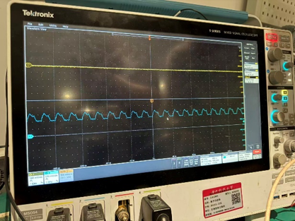

2. When the SCLK source is set to "SYSREF", the output signal period is correct, but the waveform is distorted. As shown in Figure 2.

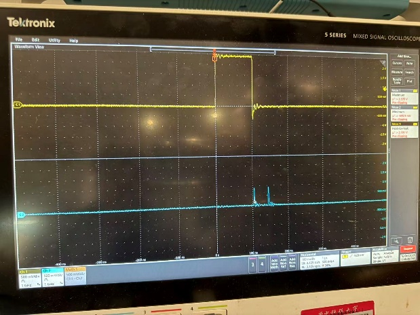

3. When using the SYSREF pulser for output, the signal is similar to the continuous SYSREF, as shown in Figure 3.

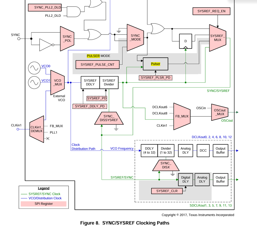

Summary: OSCout successfully outputs SYSREF, but SCLK fails to output continuous SYSREF or pulse SYSREF. A preliminary judgment suggests that the possible cause might be some issues with SYSREF_MUX. Please help to check.
