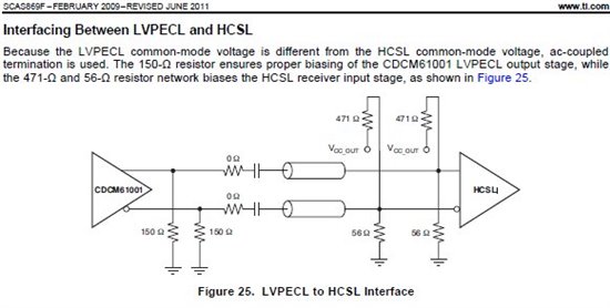

When LMK03806’s CLKouts are used as the inputs of HCSL receivers,  what are the termination for DC coupled operation?
  • Hi Ted,
    What is the differential signal you’re trying to interface to the HCSL receiver’s input?  HCSL receivers typically expect 0 mV to 700 mV single-ended swing with Vcross at 50% Voh.
    HCSL reference: http://download.intel.com/design/Pentium4/guides/24920601.pdf -- See Table 4.1: AC Timing Requirements from one of Intel's spec (pg. 24).  Note that this shows Intel’s driver output specs.  HCSL receiver input specs may have some guard-band and may vary between devices/manufacturers.
    SSTL reference: http://www.ti.com/lit/an/scba014/scba014.pdf
    HSTL reference: http://www.ti.com/lit/an/scaa062/scaa062.pdf
    Alan

    Since LMK03806’s CLKout can be configured LVDS or LVPECL, do you think which one  is better?
    For LVDS and LVPECL drivers , what are the terminal between drivers and HCSL receivers?
    Thanks again.
    My reply:
    Hi Ted,
     I’d choose LVPECL16 since LVDS may not have enough swing for an HCSL receiver's input.  It should be ac-coupled as explained/shown below.
    I don’t really understand this question:  “For LVDS and LVPECL drivers , what are the terminal between drivers and HCSL receivers?”  If you're referring to termination, then the LVPECL-HCSL interface circuit above takes care of both common mode shifting and load termination (471 || 56 = 50 ohms, place close to HCSL inputs).
