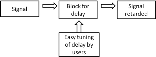

  • Hhhhm, I think that it's better to explain the problem with a picture.
    Input signal (f=8MHz) should be retarded. This delay should be in the range [10 -200 ] ns. Dealy must be tunable by the user in an easy way.
