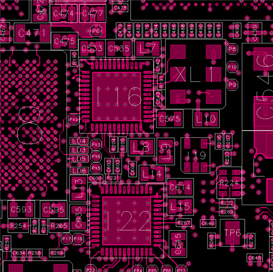

  • Here's the layout...
  • Hello Richard,
    the schematics and the layout is fine. Could you please try in the first device to disable the input termination? This can be done be setting bit 8 register 5 to '1'.
    Julian
