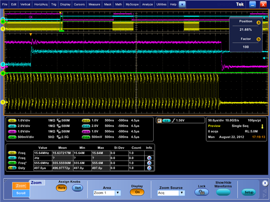

   I'm using cdce62005 with spartan6 FPGA, cdce62005 works as a jitter cleaner for the gtp 125MHz reference clock, it works fine. I can get a stable recovered clock from the gtp. Now I want to switch the clock source of the cdce62005 from a local 125MHz clock to the recovered 125MHz clock, after switching for some micro seconds, cdce62005 loses lock. The only clock source for me is sec_ref, so I implement a internal mux  to do the switch job.
   The clock switch happened at the rising edge of the blue channel, the red channel represents the cdce62005 lock signal, the yellow one is the aux_out which is 1/8 of  the reference clock(sec_ref)   .From the waveform I didn't see any obvious change before and after the clock switching, I can't understand why cdce62005 can't lock at the new clock.

    If the Yellow signal represents the AUX signal which shows 1/8 of the reference clock, then it is clear that the CDCE62005 looses lock. It seems like your recovered clock disappears which causes the PLL unlock. As i can see from the not zoomed part of the scope plot the device recovers lock after the reference signal is valid again.
    Could you please verify if the recovered clock is stable?
    If you would connect the local 125MHz clock to SEC_REF and the recovered 125MHz clock to PRI_REF you could avoid the problem by using the internal smart mux which switches automatically if one source fails. Register settings for this solution:

              Second: The recovered clock highly relies on the data link, and the data link highly relies on the output of cdce62005, the system initially work with a local clock , and the recovered clock is stable, after switching to the recovered clock, before the cdce62005 lock to the recovered clock, the data link is not stable because of the unstable cdce62005 output , thus the recovered clock is not stable, it's a loop.
             Since I don't have pri connection, I managed to implement a auto switch from aux_in to sec. The aux_in is 31.25MHz and the sec input is 125MHz , the reference divider is 4, so that the reset of the setting is the same for both aux_in and sec. Aux_in is always valid, sec input firstly connects to 0 and then connects to recovered clock after getting a stable data link, result is still the same, cdce62005 lose lock result in an unstable data link.
             Could you please tell me how can I use the holdover mode, maybe it can help.
