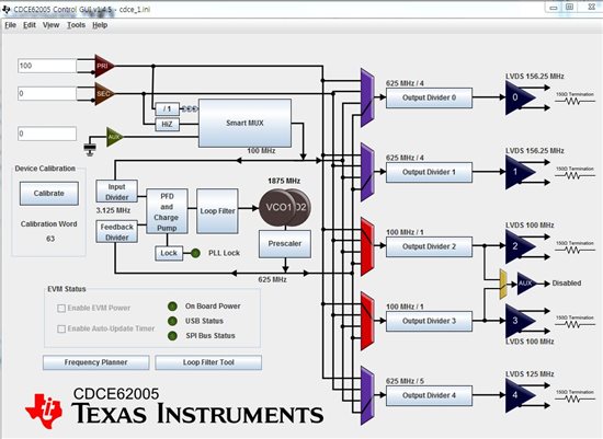

I develop PBA with TI DSP 6678 chips.
In using the DSP input clock for CDCE62005, I have questions.
I have used the tool of CDCE62005_GUI_v1.4.5.
I was setting the clock rate, and get ini SPI data through SPI Debug option.
I use this data to control 62005 with SPI program of CPU.

I don't see the PLL_LOCK is high, and Clock Outputs are very unstable.
My questions below.
1) In word6, I don't know to use which value is "295f8f8f" or "295f8f86".
2) Is this setting value correct?
3) Do you have any version of GUI program?
Thank U..

  •  Hi,
    could you please try the attached .ini file? I tried it out on the EVM and looks like it is locking. The bandwidth will be 237kHz and the Phase Margin roughly 60 degree. Please make sure that you have a working connection between GUI and your board.
    Leandro
    CDCE62005_E2E.ini

  • Hi Hanjun,
    could you please check that the Smart MUX has the PRI_REF selected?
    Also the v1.4.5 is not designed to work in a Win7 environment. The version for Win 7 is not yet officially released to the TI webpage.
    Please contact TI FAE or Sales representative for your account for further information.
    Leandro

  • Hello Hanjun,
    please try out following settings:
    REGISTERS
    0    eb840320
    1    eb840301
    2    eb400002
    3    eb400003
    4    eb860334
    5    803c2e45
    6    2ce09a6
    7    fd90fba7
    8    200099f8
    I got the lock condition, but you may need to tune the setting for the loop filter to achieve the best performance out of your input clock.
    If you have ENCAL_MODE=0, there is no need to write the ENCAL.
    The right power up sequence is Power ON - SPI_LE high - PD enabled. You can start to write the SPI only after PD is enabled.
    I hope this can help
