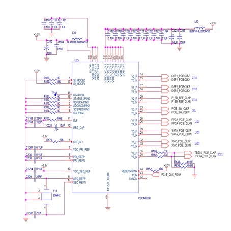

We have used CDCM6208 clock buffer in our design
We have connected 25MHZ as clock input and need to configure CDCM6208 output clock as 100MHZ .
We probed input clock and we are getting 25MHz clock , but we are not getting output clock
I have attached the schematic part of CDCM6208.
Please let us know if there is any issues
