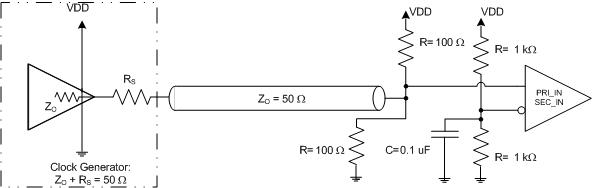

Please advice how to terminate clock input to CDCLVC1310.
Data sheet and Evaluation board document provide conflicting data:
Datasheet calls to terminate input to Pri IN and SEC_IN which is most likely mis-type:. Please confirm this.
Datasheet also calls for 100k pull up/pull down resistors on signal input and 1k pull up/pull down resistors on unused inverting input;
Evaluation board schematic shows 100 Ohm pull up/pull down resistors on both inputs.
Please help to sort this out.
Andrey
  • Hello Andrey,
    thanks for pointing this out. We will change this typo in the next datasheet revision.
    The datasheet should look like this, with 100 ohm differential termination:
    Anyway, you may not need to use the components on negative input, because the CDCLVC1310 has internal 100k pull up and pull down.
    In the user guide most of the shown components are "do not install".
    julian
  • Hello Julian,
    1. Thank you for clarification.
    I believe you got another 'typo' in this section of diagrams.
    Look how your inputs are named: The positive is PRI_IN and the inverted is SEC_IN.
    Should the positive be PRI_INP and inverted one - PRI_INN?
    (Alternatively positive: SEC_INP and negative: SEC_INN?)
    Please confirm this or correct me if I am wrong.

  • Hello Andrey,
    thanks to your findings, the recently released CDCLVC1310 datasheet is now without typos.
