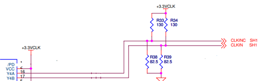

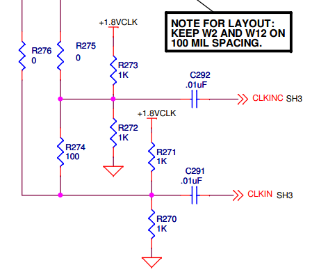

    About the schematic of DAC5670_EVM , i have some questions i can not understand ! From the datasheet of DAC5670_sp , i found that the input clock (DACCLK_P/N) of DAC5670 is compatibal LVPECL. But when the CDCM7005's output clock is LVPECL ,why another net is added between input of the DAC5670 and output of CDCM7005 (From the DAC5670_EVM)? Can i delete the net ? The net is followed:
    Regards, Lei
