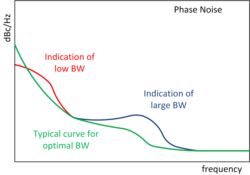

  • Hello Boris,
    Going back through the thread, I noticed you changed your external LF setting to "0100", are you still using the external components as before?
    C1 = 470 nF  or 220nF, C2 = 47 uF, R2 = 10 OHm
    In that case your phase margin might be on the critical side, it's around 52-57 degrees. given that you are starting at corner tempratures, I would highly recommend to increase this phase margin for reliable locking, make sure it's above 70 degrees to have enough margin on the temp corners.
    you can use the CDCE62002 GUI loop filter tool to predict the phase margin as in the picture attached.
    Regarding jitter performance, the optimum performance is achieved when the loop bandwidth is set such that the open loop contribution of the VCO and the reference source phase noise contribution are balanced. if you know you have a noisy reference source, then you might need to tighten your loop-bandwidth (maintaining enough phase margin).
    one easy way to see if you have the proper BW is to monitor the output phase spectral density on a phase noise analyzer like Agilent E5052A, a hump in the phase noise plot is an indication of too large BW, a high close-in noise level is an indication of a narrow BW.

  • Hi Boris,
    Your phase margin sounds good. is the failure to lock happens to the same chips randomly? or can happen to any chip?
    Is the reference input available at the time of reset? or the reference itself goes through reset?
    The calibration process requires a stable input. it works better with lower PFD frequencies, so this is something you might try to lower fPFD.
    Please also try to repeat the PD/PU for triggering the calibration in case of calibration failure after some time delay.
    Ahmed
