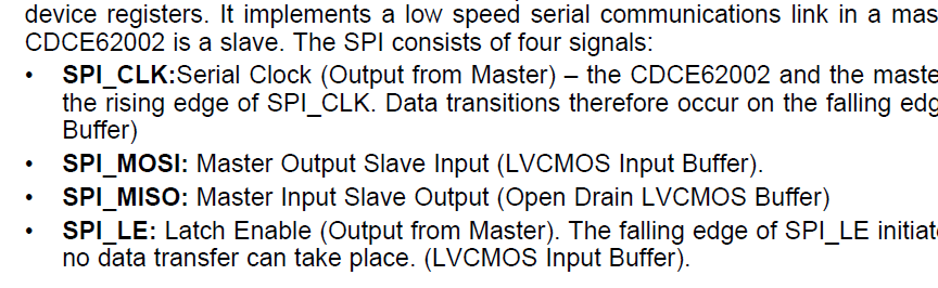

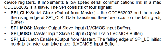

    Thanks for the input. Two things to clarify:
    1) Is this common practice with SPI to use pull-ups to ensure known-good state, or is it a "feature" of our part?
    2) The CDCE62002 datasheet says MISO is Open Drain. If this is an error, can we edit the datasheet?
