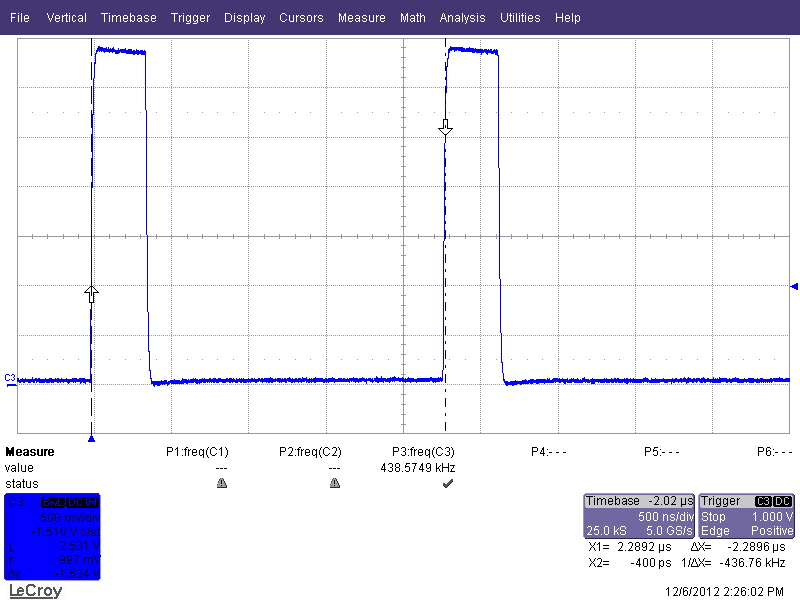

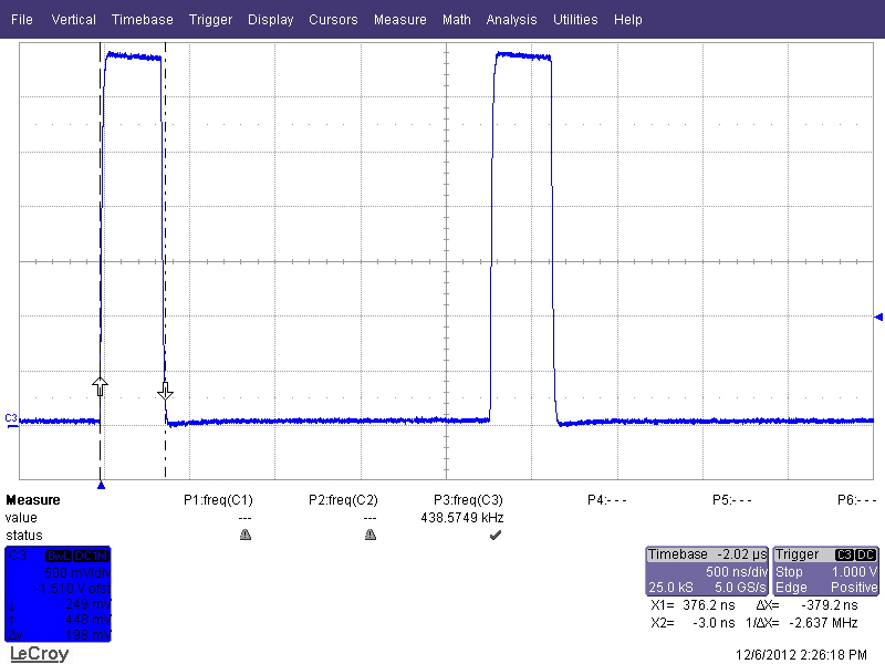

    After extensive testing of the PLL, we notice that it locks sometimes but in most cases the PLL does not lock.
    The signal of the PLL_Lock "jitters" Indefinitely. Attached are scope captures of the PLL_Lock signal.
    The PLL settings are as follows:
    0          e9 07 ff 20
    1          e9 07 ff 21
    2          e9 07 ff 02
    3          e9 07 ff 03
    4          e9 07 ff 14
    5          10 00 0b 35
    6          00 2F 03 e6
    7          BD A1 79 E7
    We checked voltages are good and the 25MHz crystal is working.
    Please advice!
    can you tell, do you trigger by the time the device is starting up or after several seconds?
    Because the calibration and lock  takes a time, it`s depending on the input clock and loopbandwidth.If  you need -> CDCE62005 on page 67/68 you`ll  find detailed information about start up and calibration times.
    The locksignal should be High for lock.
    Best Regards
    Michael
