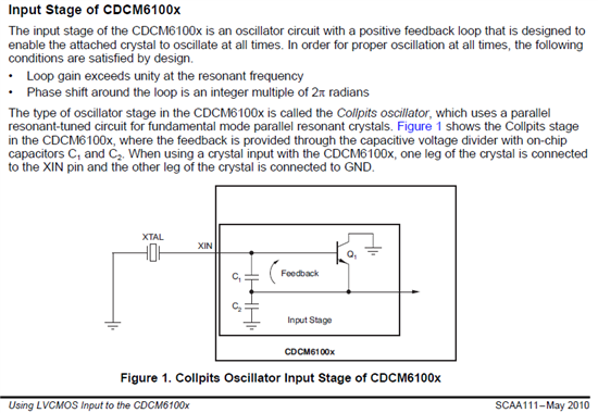

       I am using the CDCM61001 as a clock generator. I read the datasheet, TI recommend three crystals. But unfortunately, I could not find the product based on the part no.
      Since the CDCM61001 accepts single ended crystal input, but the normal crystal has two inputs and two grounds. So may I know that how do I connect the crystal to the CDCM61001?
      Could I just use one input only and then connect another input to ground?
      Thanks and happy new year.
  • Hello Xiaoliang,
    a crystal is always a "2 port" device. So you have the 2 electrodes and the quartz stone in between. Many of the SMD packages have additional connections, which are used to ground the package.
    Anyway, the CDCM61001 has a special kind of crystal oscillator stage. It is called Collpits Oscillator. It used a positive feedback loop, which allows to connect just one electrode of the crystal. the other side is connected to ground.
