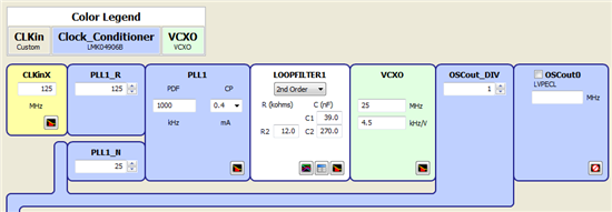

    For PLL1, according to clock design tool sims:
    With a 100 uA charge pump current: phase margin is 32.2 degrees and loop bandwidth is 60 Hz
    With a 400 uA charge pump current: phase margin is 17 deg and has a loop bandwidth of 131 Hz.
    I can get the PLL to lock with either setting, of course the 100 uA would be more stable (the .mac file above has 400 uA charge pump for PLL1, you may try decreasing this by right-clicking on PLL1 charge pump current value on PLL1 tab.  You can increase by left-clicking on PLL1 charge pump current value on PLL1 tab).

    I recommend re-designing the PLL1 loop filter, here is a design I did to match the 12 Hz/50 degrees phase margin originally intended for PLL1.
    C1 = 39 nF, C2 = 270 nF, R2 = 12 kohm; PDF = 1000 kHz, CP = 0.4 mA, VCXO = 25 MHz.
    Other than the updated documentation, are there any other questions or design issues with the LMK04906 I can help you with?  I apologize for this error, you have every right to be upset about this.

    Epson VG-4231CA, GRC type.  Datasheet is at: http://www.eea.epson.com/portal/pls/portal/docs/1/1545709.PDF
    Here was what I characterized the Kvco on my board, ~4.5 kHz/V:
