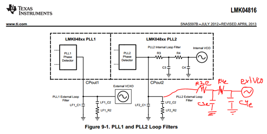

  • For LMK04816, if an external VCO is used by connecting the VCO to Fin/Fin* pins, are the integrated loop filter resistors (R3 and R4) and capacitors (C3 and C4) for PPL2 still available for use with the external VCO? Or, are the integrated loop filter capacitors and resistors only for the internal VCO?
  • R3/R4 and C3/C4 are only for internal VCO.  However they could slightly impact external loop filter.  Since the values/caps are so small, I expect any impact to be very minimal, but best practice for external VCO design would be to maximize R3/R4 and minimize C3/C4.  Then if a 3rd or 4th order filter is desired with external VCO, use R3e/C3e/R4e/C4e.  See image below:
