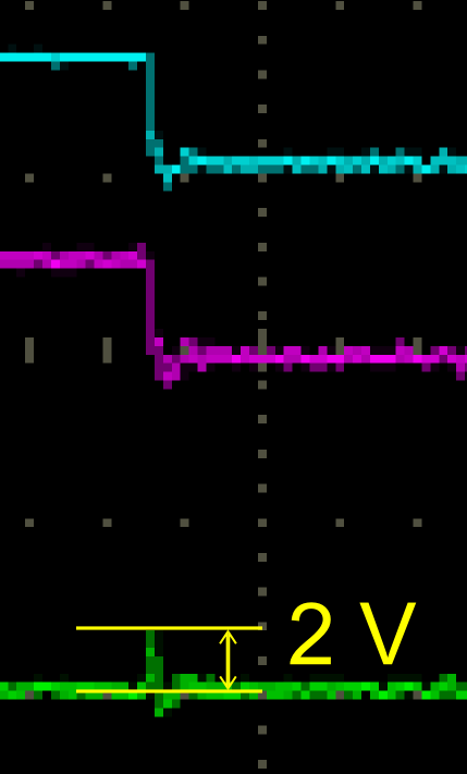

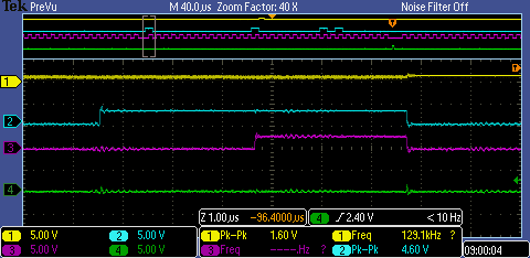

Here, before the 0x80020140 sequence was started, 16 empty bits are clocked out to clear all buffers.
There was also a test without the first 16 zero bits, same result.
[FIGURE 5 - HW SPI - Full View on init Data 0x80020140]
[Figure6 - HW SPI - Zoom on first Bit]
It can be seen here, that the bit setup is done on falling edge, and read in can be done on rising edge.
Trigger is set here on LatchEnable, already armed when uC program started running. So no LatchEnable happens before this point in time.

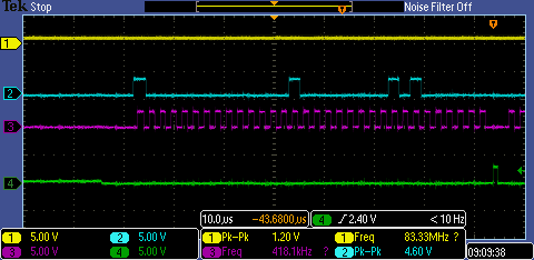

Hardware SPI - not working too, but strange result
Here, the SPI Settings were changed from firstEdge to secondEdge. I know that this setup should not work in general, but it was just a try because nothing else worked either.
The LMK now responds after finishing the programming sequence with enabling Pin 33 to High. But the Output Clocks are not correct. This Test was just done to
[FIGURE 3 - SW SPI - Full View on init Data 0x80020140]

    Thanks for your detailed analysis of your SPI/MICROWIRE data.
    It appears on your hardware SPI send, there is a fairly large voltage spike on the LE line.  With the channels configured at 5 V/div, This spike is almost 2 V.  This would cause a premature loading of the input shift register into the decoded address register which would destroy intended programming.
    One method to do a simple confirmation of SPI write is to toggle the LD pin high/low by programming LD_MUX = 0 (logic low) and LD_TYPE = 3 (Output) and 4 (Output-inverted).
    For LMK03806, the Vil is 0.4 V, which assures a low input and the Vih is 1.6 V, which assures a high input.  You need to keep the LE below 0.4 V until LE is asserted to load the whole word.  I noticed the software SPI didn't seem to have this spike at the end.
    I suggest you place a filter capacitor on the LE/CLK/DATA line.  Perhaps 100 pF?  Then re-examine the waveform on a smaller V/div so any spike can better be seen.
    Another option to possibly help with the spike is to source terminate with a ~33 ohm resistor the output lines driving the LMK SPI inputs.

  • Thanks Timothy,
    I changed the Slew rate for the SPI and the LatchEnable pins to Slow and it works right now.
    For the final design we will consider source termination and lowpass filtering
