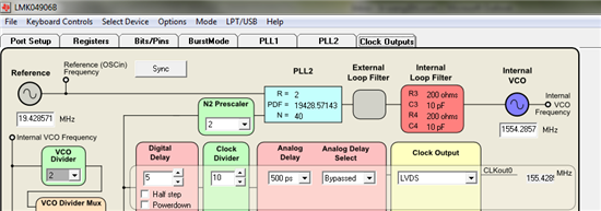

Our customer has a question about the frequency multiplying of LMK04906 device.
They want to make from the input frequency '19.42857143.....MHz' to the output frequency '155.4286MHz'.
The rate of multiplication is 8.
LMK04906 device can provide the frequency (155.4286MHz) ?
Also, the input frequency '19.42857143...MHz' is programmable by 122.88MHz multiplideb by 1275 and divided by 8064.
Kato / Japan disty
  • Hi Kato-san,
    Your input frequency of 19.42857143 MHz is within specs for the CLKin. As for the output frequency, you have many options for generating 155.4286 MHz. Take a look at the below configuration for example:
    Please let me know if this is what you were looking for. Thanks!
