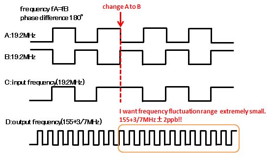

Our customer want output fluctuation range extremely small without holdover under the following congitions.
When swiching A to B, Can you achieve output fluctuation range of 2ppb?

Hi, This fine frequency difference is not possible with the LMK04906.
