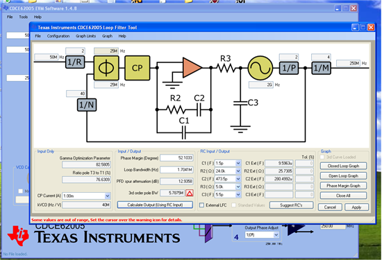

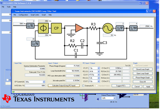

    To verify the R/C values of Loop filter and to calculate the Bandwidth of PLL, I have used the CDCE62005 EVM Software 1.4.8 in which I entered the suggested values.
    When I entered the values, I found following observation:
    1. When the Charge Pump current value was 1mA the BW calculated from the tool was around 1.7 MHz, with a warning on 3rd order pole BW.
    2. When the charge current reduced to 300 uA, the warning disappeared with BW=473 KHz.
    I would like to know how you've derived capacitor and resistor values w.r.t bandwidth value (is it based on formulae substitution or trial and error method) ? If it is based on formulae substitution (R,C values vs BW value) then I kindly request you to inform the formulae you've used.

  • Hi Vijetha,
    I made a typing error. I did go through the tool but I used 200uA charge pump current. Another option is 300uA with C3 = 5.5pF for a higher 3rd order pole.
  • Dear Madhu,
    Yes you are correct, with 200 uA of charge pump current value I am  able to achieve Loop bandwidth around 300 KHz - 400 KHz. I just wanted  to know (as I asked in previous post) how these values (R,C, charge pump current value, Bandwidth) are achieved? Is there any procedure/formulae to design these values?
    It would be greatly helpful, If you share the method/formulae you've followed to design these values of PLL filter.

  • Hi Vijetha,
    The procedure is based on closed loop analysis including frequency response of a PLL. You can calculate the -3dB point and the phase margin with these formulas. The detailed theory behind this is given in the excellent book by my colleague, Dean Banerjee. It is here http://www.ti.com/tool/pll_book
    The theory is implemented in the loop filter design tool in the CDCE62005 EVM GUI. You can use that software to design your loop filter.
