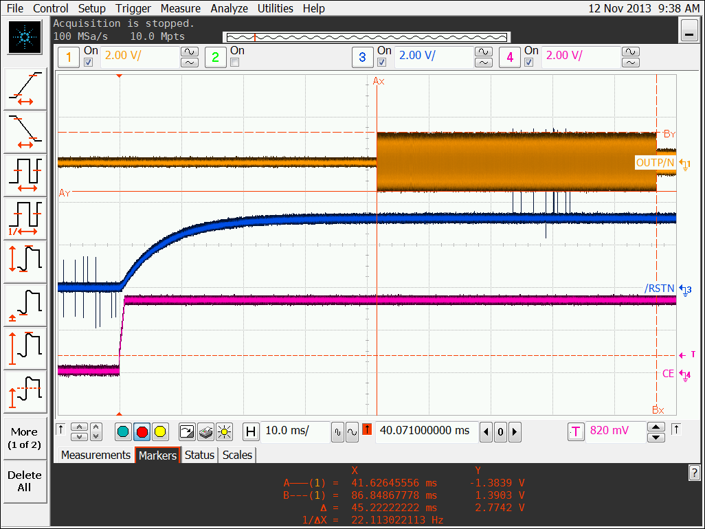

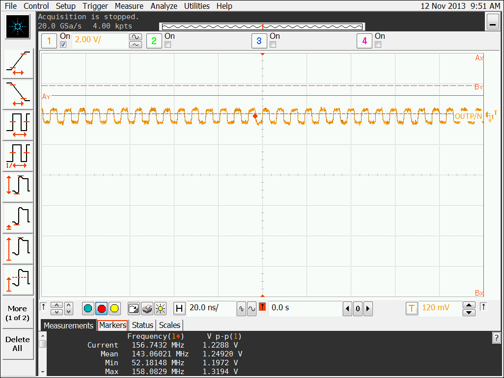

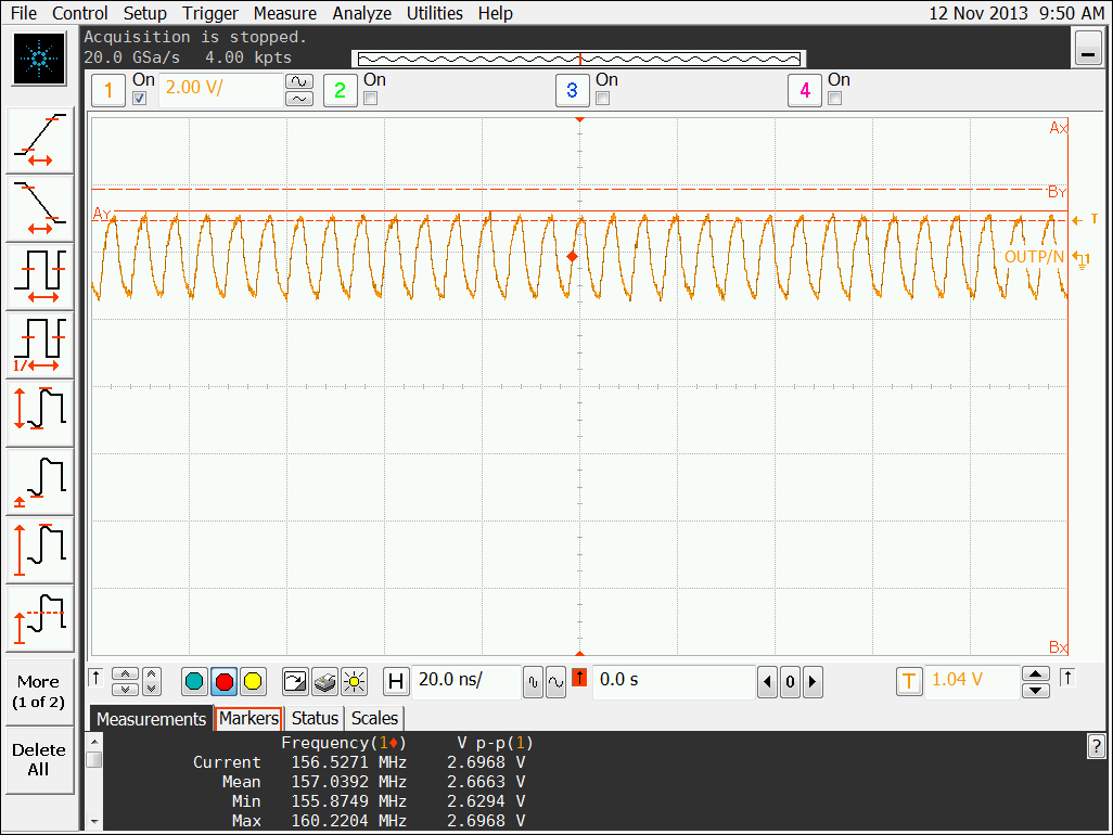

Our customer  put 1uF capacitor on the /RSTN pin to GND to avoid issue that is occur to be not stable output at power on.
Datasheet recommend /RSTN pin would be a 47nF capacitor to GND but it does not specify max value.
(refer from 20page)
Are there any issue to put 1uF capacitor on the /RSTN pin to GND?
