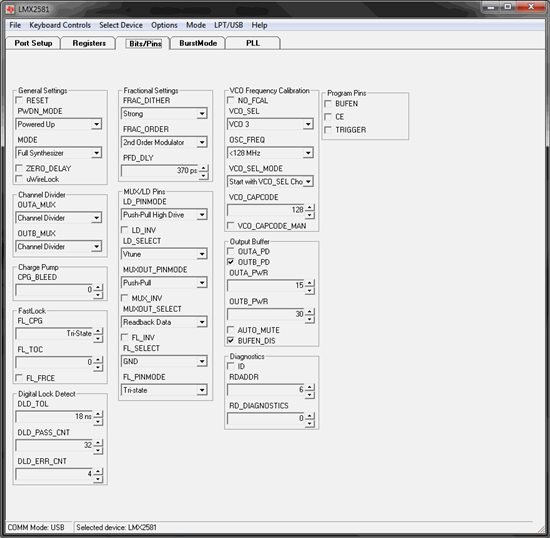

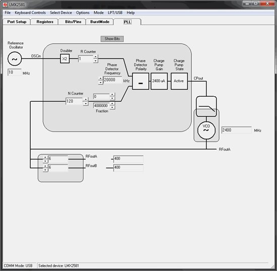

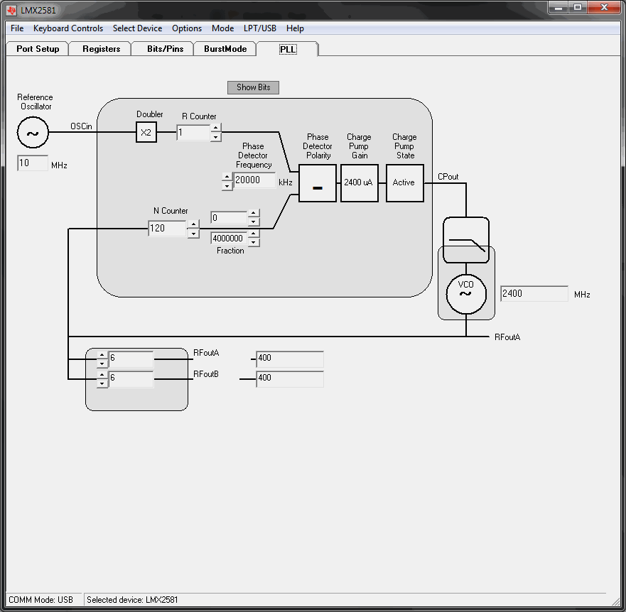

    Here is my codeloader config:
    PLL tab:

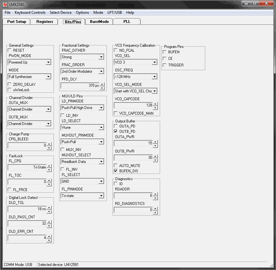

    Bits/Pins tab:
    I've changed LD_SELECT of course for the measurements.
    And here are the Registers:

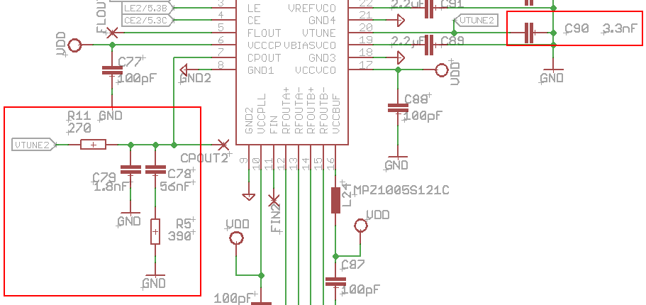

    And here is my loopfilter (taken from the LMX2581EVM):

    I'm not sure what is going on either, but it looks as thought the VCO is calibrating to the proper frequecy, but then the frequency drifts upward.   Realize that this device has a negative coefficient VCO, which means that if you put lower tuning votlage, the frequency goes up.  For instance, if your oscilloscope probe is a 50 ohms to ground, this could load down the loop filter and cause the VCO to go to higher frequencies.  During calibration, thie loop filter is switched out, so this would not impact the VCO calibration.
