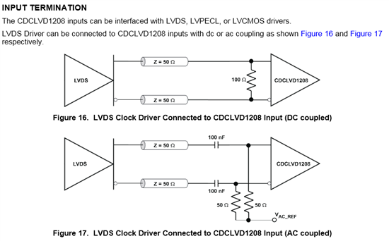

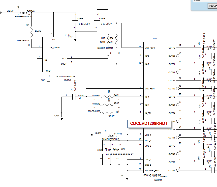

I  use with CDCLVD 1208 as buffer clk 100Mhz 50ppm to FPGA and then to DDR3 ,one of the Oscillator not working well , when I by-pass the buffer and connect direct to FPGA it's working. in the past this Oscillator kind working well ,
other option i connect the Oscillator as single ended it's also working , what could be whorg with buffer ?
see picture drwing .
