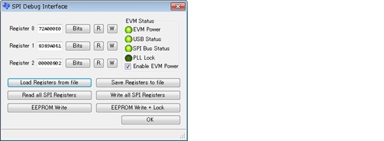

Hi Team,
Could you please tell me about the initial register value of CDCE62002EVM after power up.

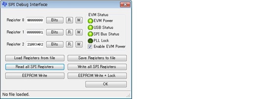

When you open the GUI, it will show the default value of the EEPROM. However, when you click "Read all SPI Registers" the value changes.
Does this mean that EVM does not read the EEPROM data automatically ?
I need to know the initial state of CDCE62002.
EEPROM Default Value
Value after reading SPI registers
Kawai
  • The default EEPROM values should match the values shown in Figure 21 of the datasheet.  Since you readback register 0 and 1 with all zero values, can you confirm the device supply voltages are correct, SPI signals are correct at device pins, and EEPROM was not overwritten and locked accidentally?  Are you able to write new register values and read-back the values correctly?
