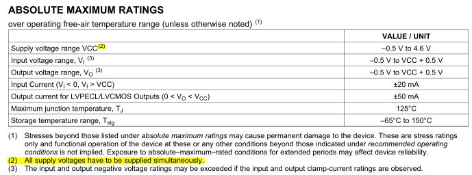

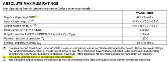

Could you please let me ask you about the power up sequence of CDCE62002 ?
I found the datasheet mentions that all supply voltage should be supplied simultaneously.
Our customer uses separate power supply to the analog supply voltage and the other supply voltage.
(Analog supply voltage is applied from LDO and other supply voltage is from DC/DC converter.)
[Question]
What would be the restriction to satisfy Note(2) above in the absolute maximum ratings ?
Please give us your advice.
