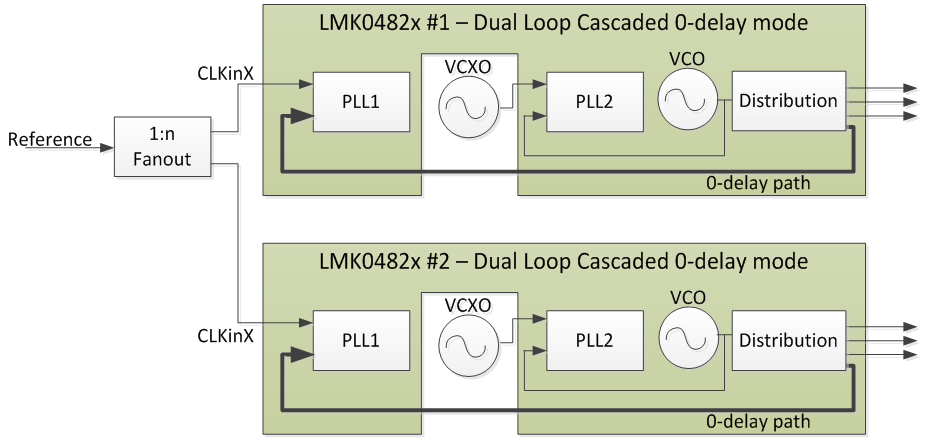

    Depending on reference source, it is also possible to put two LMK0482x in parallel, using 0-delay and SYSREF as a feedback to common SYSREF frequency source.

    Could you give me more details about how to put two LMK0482x in parallel?
    In addition, should we use 0-delay mode in this case?

  • Hello Kato-san,
    By configuring the device for 0-delay mode and feeding back the SYSREF frequency to PLL1, this allows the lowest frequency clocks between 2 or more LMK0482x to share phase.  When each LMK0482x SYNCs it's clocks - all clock outputs have deterministic phase alignment.  Provided the SYSREF frequency is the GCD or smaller of all the output frequencies of an LMK0482x, all phases will have alignment across parts.  You can use the info in Table 1-3 or 1-2 of datasheet to configure the actual 0-delay mode.
    When using parallel LMK0482x I suggest using dual loop for this because SYSREF is typically a low frequency which would otherwise limit PLL2 phase detector frequency.  To ensure best PLL performance high phase detector frequencies result in best PLL2 phase noise performance.  See slide 17 of Choosing Loop Bandwidth for PLLs http://e2e.ti.com/support/clocks/m/videos__files/664163.aspx to see this illustrated.  If your application can accept the worse PLL2 performance, then it is ok to use single PLL mode without VCXO.
