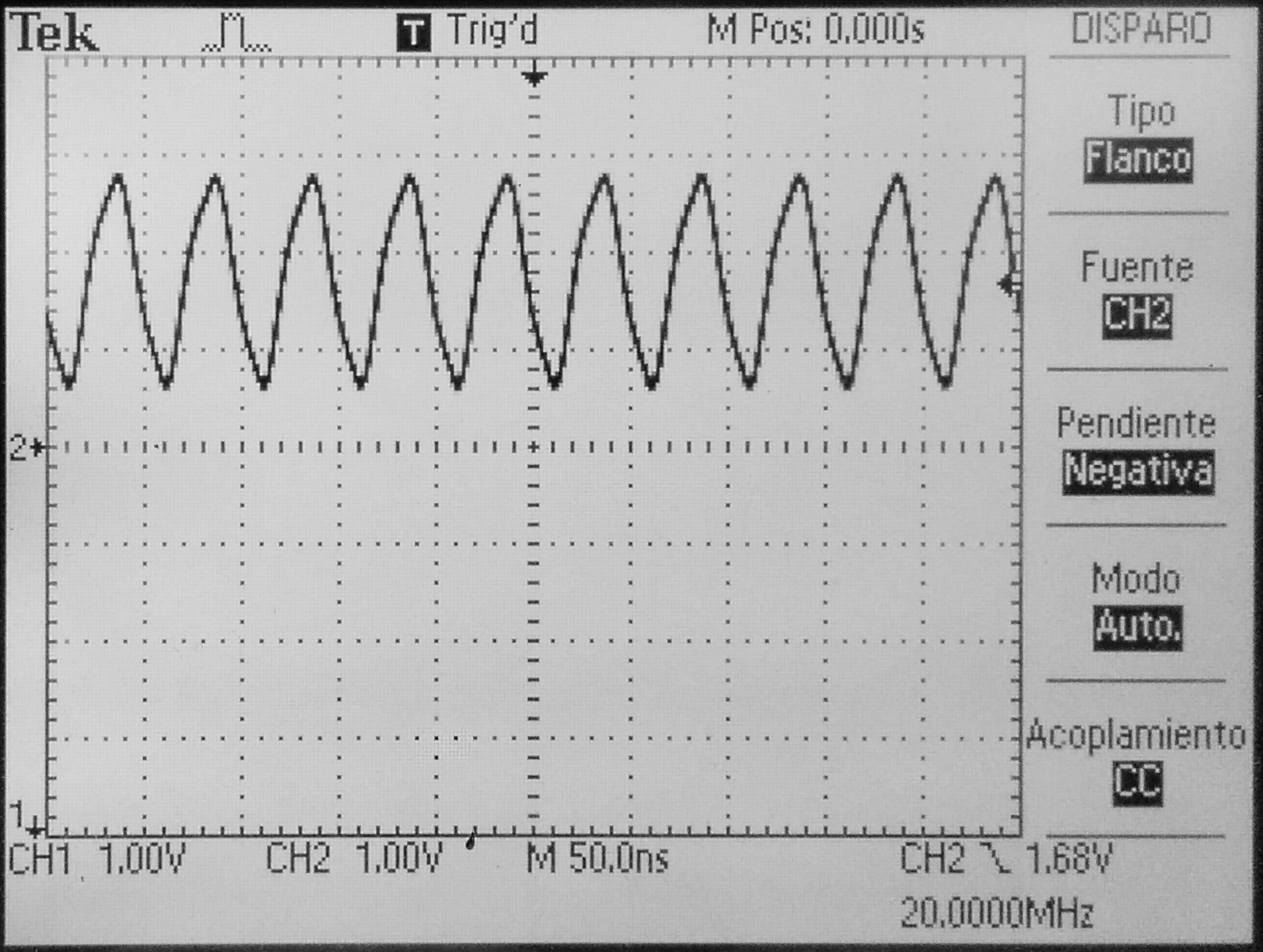

    Is your reference clock at OSCIN stable before R15 is programmed to initiate the VCO calibration routine?
    Alan
  • First of all thank you for your interest, as mentioned earlier I'm driving the OSCin single ended by a LVCMOS level oscillator, which seems stable during R15 programming, as seen on fig 1.
    Fig. 1 Input signal coming into OSCin.
