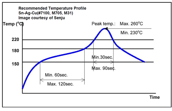

I am using a number of LVDS clock repeaters and synthesizers (CDCLVD1208RHDT, CDCE62005RGZT, LMK00105SQE/NOPB) in our design. All these parts are QFN package.
I need following parameters for Soldering / Reflow procedure of these parts:
1. Pre heat Temperature range
2. Pre heat duration
3. Liquidus Temperature
4. Time above liquidus temp
5. Reflow Temperature Range
6. Pre heat ramp up rate
7. Reflow ramp up rate
8. Ramp down rate
I got following profile in an application note of TI; but did not get the values of these parameters.
Please provide these details.

I was told the answers you are looking for can be found in the following applications note.
http://www.ti.com/lit/an/snoa401r/snoa401r.pdf

Thank You Arvind Sridhar. It was useful document.
I also have another package TO-PMOD (Part LMZ12001TZ-ADJNOPB). Its clearly mentioned that the peak reflow temperature max is 245 deg C. May I know what is the minimum reflow temperature that can be maintained?
Also there are no details on Pre heat, Liquidus temperatures and ramp up rates for this package. I am not sure whether I can consider the values mentioned in the document you sent in previous reply for TO-PMOD Package. Can you provide these parameters (Pre heat temperature, Ramp up rates, Liquidus Temperature and Minimum Reflow Temperature).

You can find LMZ module SMT guide in the following link:
http://www.ti.com/lit/an/snaa214/snaa214.pdf
