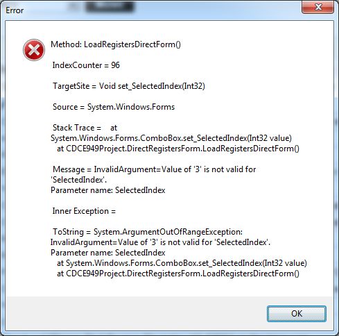

I have a design using the CDCE925 that has been in production for a few years.  Most boards work fine.  A handful have an issue communicating with TiClockPro.  I have attached a screenshot of the error message.  I get this error when the software is first launched, and then once within the application.  After the second time I get an even longer cryptic message and then the software crashes.
If I load the software with a "good" board I can get to a point where the good board communicates fine.  Then I power the board down, disconnect the i2C cable and connect the "bad" board.  I am able to program the device but get an error message complaining about Fvco out of range and do I wish to modify N, M, P, and Q to generate the nearest valid Fvco.  I programmed the parameters used on all the "good" board so I am not sure what parameters are off. If I press No, it just pops up the same error in an infinite loop.  If I press "Yes" I just get the same error message as before.  I know the device gets programmed because the clock changes.

  • These are custom boards for an application in digital audio.  We have made several thousand boards and most work fine.  I have a couple that are experiencing this problem.  We like to root cause all issues.
    Using version 1.2 of the TI software I followed your suggestion but I can't get past step 5.  When I press refresh the software only shows 4 "Local" listings, not the connected hardware.
    I unchecked the two items in step 4, loaded a saved configuration file, and then programmed a board giving me the issue.  I can see with a scope that the selected frequency is indeed programmed to EEPROM (remains after a power cycle).  However, it still throws these extra error messages.  Therefore the boards may work in my application, but since the is this anomaly we have to treat them as defective.
    It would be nice to know why these errors occur other than simply calling these devices defective and discarding them.  Again, we like to know root cause.  So if you have any insight into what these error messages mean then that would help.  Thanks.

    The config file was sent via email.  Basically I hook up our product that has the TI chip on it.  Our board is "passive" with no micro or FPGA on it.  When I hook it up all I provide is power to the board which powers the chip and connect the i2C lines.  Nothing else is on the board that requires i2C.
    I then start the TiClockPro software.  After I press "skip" and the GUI starts up I get the " Fvco out of range" error message.  Pressing "yes" produces the error in the attachment.  I have tried setting my parameter manually vs. using the config file with no difference.  I also tried "Go Default" to see if I could reset the device but still receive the error.  It seems anytime the GUI reads from the device it throws the second and third error boxes I sent you via email.

  • Hello Patrick,
    I replaced the chip with a new one and the problem went away.  So it looks like an IC specific problem.  I have 2 boards with this issue (now 1).
    Other than calling it a defective part, any insight into the error messages?

    What I could find so far points to the following happening:
    In the CDCE(L)913 datasheet you will find a table about the I2C addresses of all the devices of the clock generator family. As you know the last two bits of the slave address are reconfigurable using EEPROM bits as well. Which means software-wise we cannot perfectly detect which device we communicate with as soon as any bit of the EEPROM deviates from the factory default.
    All the three error messages you provided to me are following on each other.
    The first error about the "direct register form" is basically that the software thinks it is talking to a CDCE(L)925 while in reality it is a CDCE(L)913 hardware. The software tries to read higher register offsets which in reality are not there. So it ends up in an unhandled "out-of-bound" error. (we walk through all register offsets and now we get garbled info as the offset is an unexpected value).
    Now the automated consistency checks kick in as the values are propagated within the software to the various edit boxes, check boxes and so forth. As from the I2C we receive a binary stream of data it can happen that the value mismatches with the bounds of the GUI equivalent where each of them has its own boundary limits.
    What I can state is that any bits which you read or write from the device will be ok, as long as it fits together.
    For example, let's assume you prepared a configuration for a CDCE925 and you program it into a CDCE913. That is ok as the register map is the same. The higher offsets, which are not existent in the CDCE913, will not harm the matching bits.
    When you prepare a CDCE913 configuration and you load it into a higher grade device you only programmed a subset of what you can configure. But the settings you transferred will have the effect which you expect.
    Any issues which might come on top because of a device defect are a different story and we would have to take a look separately (if you would like to get the unit analyzed).
    Moreover one additional issue which can come into play: when you connect the EVM to your application board. The EVM is designed to provide good setup and hold margins for the I2C (for the capacitance of the EVM). When you connect it to another board using cables the setup and hold times might degrade and this may influence the communication as well. I assume anything below 10inches should be ok. Maybe you can crosscheck the slew rates close to the device?
