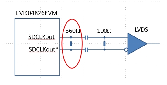

Hi! all,
My cutermer has some questions as below;
1.In case of AC termination of LVDS output of LMK04826,
  the  circuit diagram of LMK04826 user's guide shows that  there is a 560-ohm termination at the transmission
  side as below image.
   My understanding is that 560-ohm termination register is not required.
  Does LMK04826 need 560-ohm termination register?
2. If yes, why is the 560-ohm termination register needed?
    LMK04826 needs DC loop?
 3. When costomer set the register below steps, there are some different result.
     Case 1: There is no 560-ohm at transmission side.
                   Set SYSREF output powerdown to REG 0x107 &  REG 0x10F
                   Select SYSREF multiplex to  SYSREF Continuous (0x03) ; REG 0x139
                  Set SYSREF_CLR=0 to REG 0x143
                    Set SDCLKoutY_FMT=0x01 to REG 0x107 & 0x10F ; LVDS output enable
                   Result:  LMK04826 can generate CLOCK corectlly.
     Case 2:  There is no 560-ohm.
                    Result: LMK04826 can not output CLOCK.
     Case 3: There is 560-ohm.
                     Result: LMK04826 can output CLOCK.
     Why are there the diffrent results by the above cases?
     Is there any recommendation of programing step?
