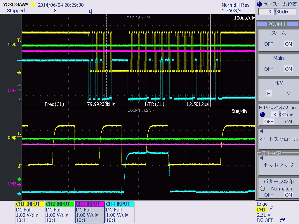

In I2C mode, what should I do with unused pins which are SEC_REFx pins and VDD_SEC_REF pin of CDCM6208?.
It may be a special case peculiar to a customer,,,,,,,
1. SEC_REFx pins are left open, and VDD_SEC_REF pin is connected to 3V_VDD.
- In this case, CDCM6208 sometimes cannot connect with HOST.
It seems that the I2C timing and ramp-up/down are satisfied with the I2C specification.
- When only CDCM6208 is mounted without FPGAs and other ICs on the same PCB,
CDCM6208 can connect with HOST completely.
2. When VDD_SEC_REF is left open or is connected to GND, CDCM6208 can communicate with HOST completely.
