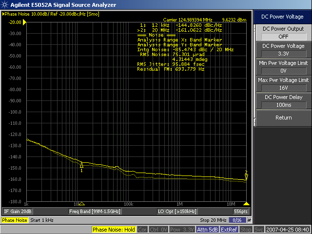

Our customer considers whether CDCV304 could meet the specification of FPGA CycloneV Transmitter REFCLK Phase Noise.CDCV304 data sheet shows 56fs[12kHz-20MHz] of rms jitter.
Could you give us the figure of frequency(Hz) vs phase noise(dBc/Hz) ?
