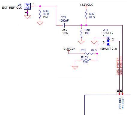

    Thank you for your response. The tool I have been using is the GUI tool for the DAC34H84EVM. Apparently this tool doesn't quite cut it, as it seems to be setting the registers incorrectly. I'm trying to get the input source to be primary, not the secondary or auxiliary.
    Perhaps you can help get the settings correctly. I am using a 50-ohm output function generator at 15MHz from 0V to 1.3V set to 15 MHz at the primary input of the CDCE62005. The input is set to LVCMOS. Here is a snippet from the schematic:
    I've downloaded the tool you suggested, and have given that a try at generating a configuration file. Note, in the configuration, I have the SEC input set to HiZ, as I do not want to use the on board (on the DAC EVM) 19.2 MHz reference. Instead, I would like to feed the 15 MHz external signal into the PLL circuitry. However, even using this configuration tool, my outputs are still running (right now at 46MHz) when I don't have an external clock connected.
    Thank you for your assistance,
    Nichoali

    Sorry for the delay in my response. At this point, I don't terribly care about the frequency plan. I am troublshooting a noise problem, and thus am trying to eliminate the 19.2 MHz Oscillator as a variable. Its nice to have frequencies in the general vicinity, but what really matters is the frequencies in relation to one another. That is, output one must be 8x output 2, and so on.  My problem, however, is I cannot bypass this 19.2 MHz oscillator for some reason.
    Looking at your configuration, I would expect there to not be a stable clock if I don't put an input into the primary. Is that correct? I am not supplying any clock to the CDCE62005, and yet, I'm still getting a stable output clock. This is not what I expect. If I connect an input clock to the device, there is no change in output frequency, even if I change the signal generator from 15MHz to 9MHz to 1 MHz or disconnect it all together- no change at all in the output frequency.

  • Hello Nicholai,
    when you write a stable output clock - did you make a phase noise measurement to confirm that this is not an open running VCO divided down?
    Does the PLL_LOCK signal show a lock?
    On a scope you will still see pretty good clock waveform, but there will be a frequency offset compared to where it should be. When you have a spectrum analyzer you might be able to see looking at the sideband shape.
    Please remember to send a calibrate command after adjusting the divider settings.
    Patrick
  • Patrick,
    I think you've answered my question. I think you are correct in that the VCO must just be open. I'm relatively new to programming PLL circuits, and didn't think that the VCO running open was something I needed to worry about. It threw me a little, because when running open, it runs very close to the same frequency when the PLL is locked.
    When changing the frequencies or disconnecting, the PLL_LOCK signal is not on, so that answers the question.
    Thank you for your time, I've learned a lot in this discussion,
