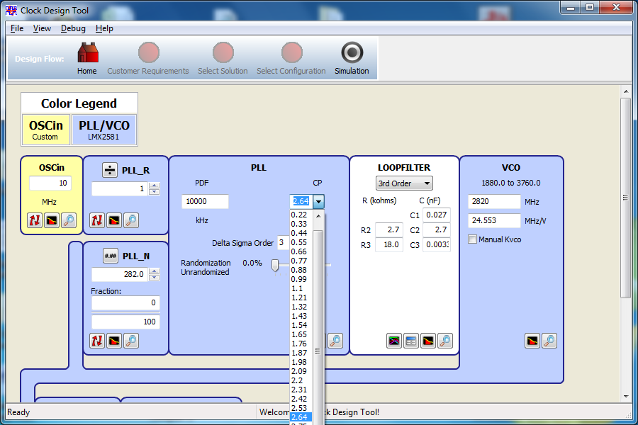

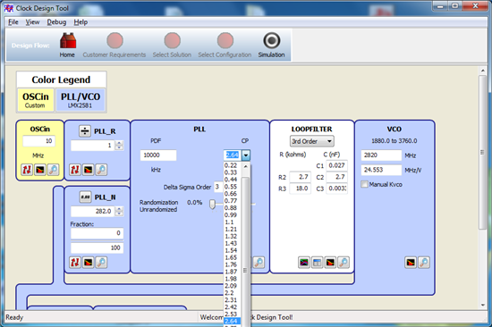

    For using the function of fast lock, setting FLCPG = 31 but I can not select a Optimozed CPG value.
    I am trying to design PLL by using Clock design tool, http://www.ti.com/tool/clockdesigntool.
    It helps user have values of loop filter but it does not give value of CPG. How can user find a optimized CPG value?
    Please let me know.
    Thanks and Best Regards
  • The charge pump gain can be selected in the "PLL" block.  The lowest state is CLG=0 and the highest state is CPG=31.   For an optimized value, the highest gain is best for phase noise.  Clock Design tool defaults to the 24x state to allow some margin if one wants to adjust the charge pump gain to accomodate for changes in VCO gain.  If you want to use Fastlock, use the 8x state, whic corresponds to 0.88 mA, but I personally would just use the highest charge pump gain all the time and not use fastlock.  Instead, use the trick to speed up the VCO Calibration.
