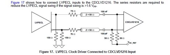

Please let me know about CDCLVD1216.
Datasheet 12-page figure-7 is attached.
Is VPP(1.6V) a single-ended value?
Or a differential value?
