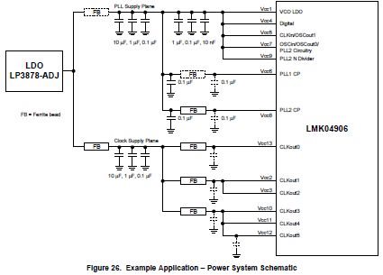

Customer is considering the decoupling of Vcc pins.
Regarding decoupling capacitors of Vcc pins, would you give us the recommendations as LMK04906 datasheet P88,89 ?
Kato
Hi Kato-San,
Please follow the general recommendations shown in the user guide for LMK04826.
http://www.ti.com/lit/ug/snau145a/snau145a.pdf
