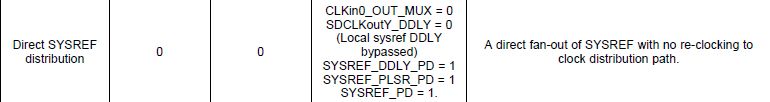

I have a question about page 36 of DS.
Regarding Direct SYSREF distribution, when is this mode used ?

This could be used to utilize the device as JESD204B fan-out type buffer. Distributing both Device clock and SYSREF.
There could also be some custom reasons for causing SYNC/SYSREF functionality to be driven by external source.
> Note it may be desired to bypass the SYSREF_MUX entirely by using SYSREF_CLKin0_MUX = 1.
