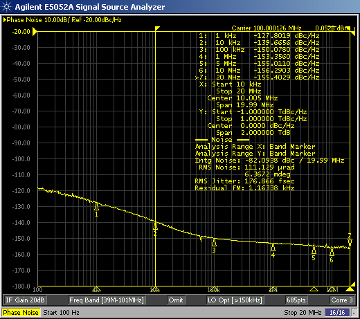

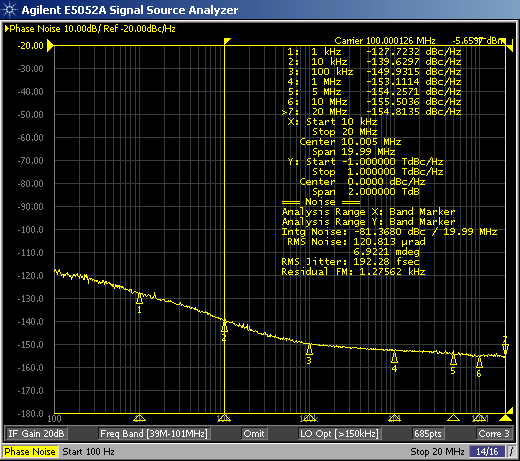

    Here is typical data for the CDCUN1208LP with a clean 100 MHz reference. Input is from a clean 100 MHz differential oscillator and output 6 is measured via a balun.
    Offset LVDS HCSL
    100 Hz -117.7 dB -118.8 dB
    1 kHz -127.7 dB -127.9 dB
    10 kHz -139.7 dB -139.8 dB
    100 kHz -150.0 dB -150.2 dB
    1 MHz -152.8 dB -153.5 dB
    10 MHz -155.4 dB -156.4 dB
    20 MHz -154.6 dB -155.4 dB
    Gabe

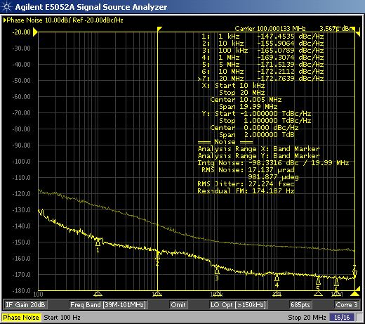

  • Thanks for the phase noise data. Would TI be willing to measure the phase noise of the 100MHz oscillator (or forward the oscillator/crystal datasheet) that they are using alone so that we can extrapolate the added phase noise of the buffer? We would also be very interested in the phase noise at a lower frequency like 19.2MHz/20MHz, 30MHz, or 38.4MHz/40MHz. Is it possible to plot the data as in the standard datasheet format?
  • Hi Tom,
    This data shows only the additive jitter only (I had extrapolated the PN for you). I'll provide the PN reference for you below however.

    Below are the associated PN plots for this typical measurement.
     Fig 1) Reference PN
     Fig 2) HCSL PN
    Fig 3) LVDS PN
