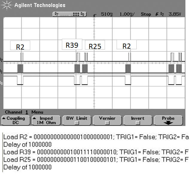

  • Hi there,
    with your configuration, I can make my board output 10MHz clock at MUXout pin. I use codeloader to control the board. my program sequence is as follow:
    1. power up the device
    2. program R2 --> R39 --> R25
    Maybe you need to check the uwire waveform to see if you have program the device correctly.

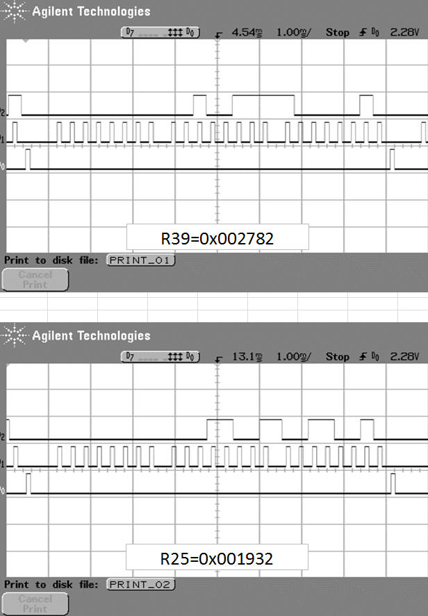

  • Hi
    Mant thanks  for your quick reply.
    This is the waveform of  DATA/CLOCK/LE  for  R39 and R25.
  • Hi
    I noticed my mistake R25 in the waveform.
    PLL_R = 50 (MUX_out=1MHz) -------->5(MUX_out=10MHz)
    R25 = 0x001932 -----------> 0x001905

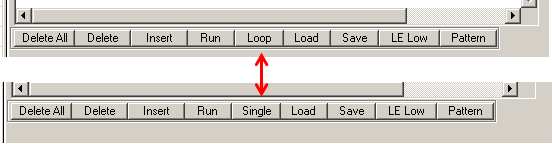

  • hi Aosan,
    it seems that you use the BurstMode but in "Loop" mode. Click the Loop button once to change it to Single, then the three registers will only be written once.
