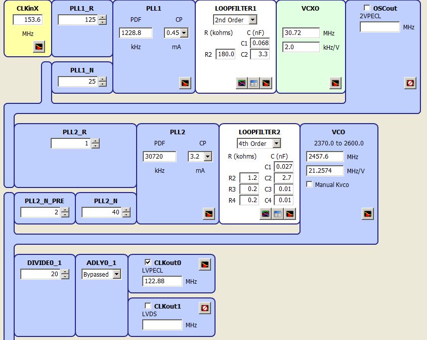

My customer reported that LMK04828 PLL2 does not lock.
And they try to change some constants of loopfilter2, but still PLL2 does not lock, and CPout2 is 0V.
Their configulation is as follows.
Could you please advise how to solve this problem?
Toshi
  • Hi Toshi,
    Is the device configured in dual PLL mode or is only PLL2 being used? If you could provide a .mac file generated by codeloader, we can further debug this issue.
    Is this being done on the EVM? What VCXO or reference to PLL2 is being used?
    Gabe
  • Hi, Gobe-san,
    Thanks  for your support.
    Now, they are evaluating LMK04828 on both their own designed board and the DAC37J84EVM.
    In case of DAC37J84EVM, they used onboard 122.88MHz VCOX and OSCin is 122.88MHz.
    And when the PDF is set to 30.72MHz (as attached file [lmk04828test_PDF2_30720khz .mac]), the PLL2 did not lock.
    The Loopfilter2 cosntant is as follows;
     R2=1.2k,  R3= 0.2k R4=0.2k
     C1=27pF, C2=10pF, C3=10pF
    When the PFD is set to 61.44MHz (as attached file [lmk04828test_PDF2_61440khz.mac]) with the same Loopfilter2 constant,
    the PLL2 locked.
    I changed the attached file extention from .mac to .txt due to the E2E system.
    So, after downloading the files, please change the file extention.
    Toshi

  • Hi, Gobe-san,
    I found out that my customer made a mistake in register setting.
    Also, I confirmed LMK04828 PLL2 locked on both their board and the EVM.
    I apologize to you for having made wasteful time by this item.
    Toshi

  • Hi Liang,
    Do you use the internal VCO1?
    If yes, please try to set "0" to PLL2_CP_POL of Register 0x169.
    The internal VCO requires the negative charge pump polarity to be selected.
    best regards,
    Toshi
  • Hi Toshi,
    I just use PLL2 mode,OSCin is 100MHz.The outpout is 125MHz as I desire.
    I have set "0" to PLL2_CP_POL of Register 0x169.The PLL2 doesn't lock still.
    The voltage of CPout2 is 1.2Vpp. I am not sure if the loop filter paremeter setted is reasonable.Should I simulate the loop filter use TI Clock design tool?
    How to set the PLL2_CAL_N?
    best regards,
    Liang
  • Hi Liang,
    I found another problem.
    PLL2_XTAL_EN of Register 0x162 should be "0" because you selected internal VCO1.
    About loop filter,
    yes, you need to simulate the loop filter by using tools for improving jitters.
    About PLL2_CAL_N, you does not use the 0-dealy loop mode. So you can set the same value of PLL2_N to PLL2_CAL_N.
    Toshi
