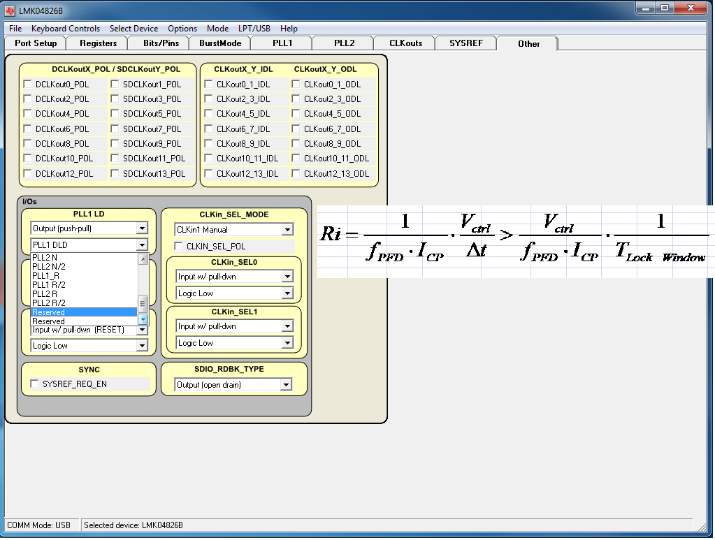

  • Hi Bin,
    Can you try the following?
    Take a look at the picture below. Set the PLL1 DLD to Reserved in Codeloader tool as shown and connect the Status_LD1 pin to a scope to observe the resulting waveform. You should see a pulsed waveform. Measure the pulse width of the waveform and note this value.
    Fpfd is the phase detector frequency, Icp = Charge Pump Current, Vctrl = 3.3/2 = 1.65V and Tlock_window = 43ns (Register 0x15B - set to max datasheet value if not set already by default). Ri is the input impedance of the VCXO (min 100k from the datasheet of the VCXO)
    In general, the VCXO input impedance must satisfy the relationship shown in the pic below in order for the PLL1_DLD to indicate valid lock. If the relationship is violated, DLD will indicate unlock (even though technically the PLL might still be locked)
    Try increasing the charge pump to meet this relationship and the DLD should indicate lock.
