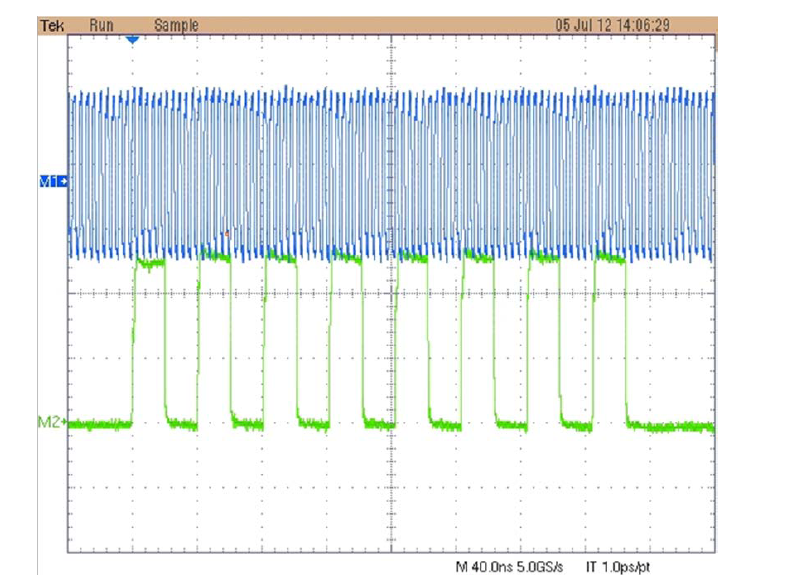

Hello,i am using the pulser mode of lmk04828,and it seems that it has been worked out;But the rectangular pulse of the output is not so steep!The user guide of lmk04828 demostrate the output as following(3.2.2  Pulsed SYSREF):

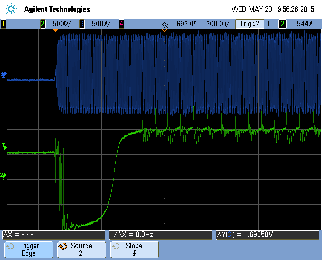

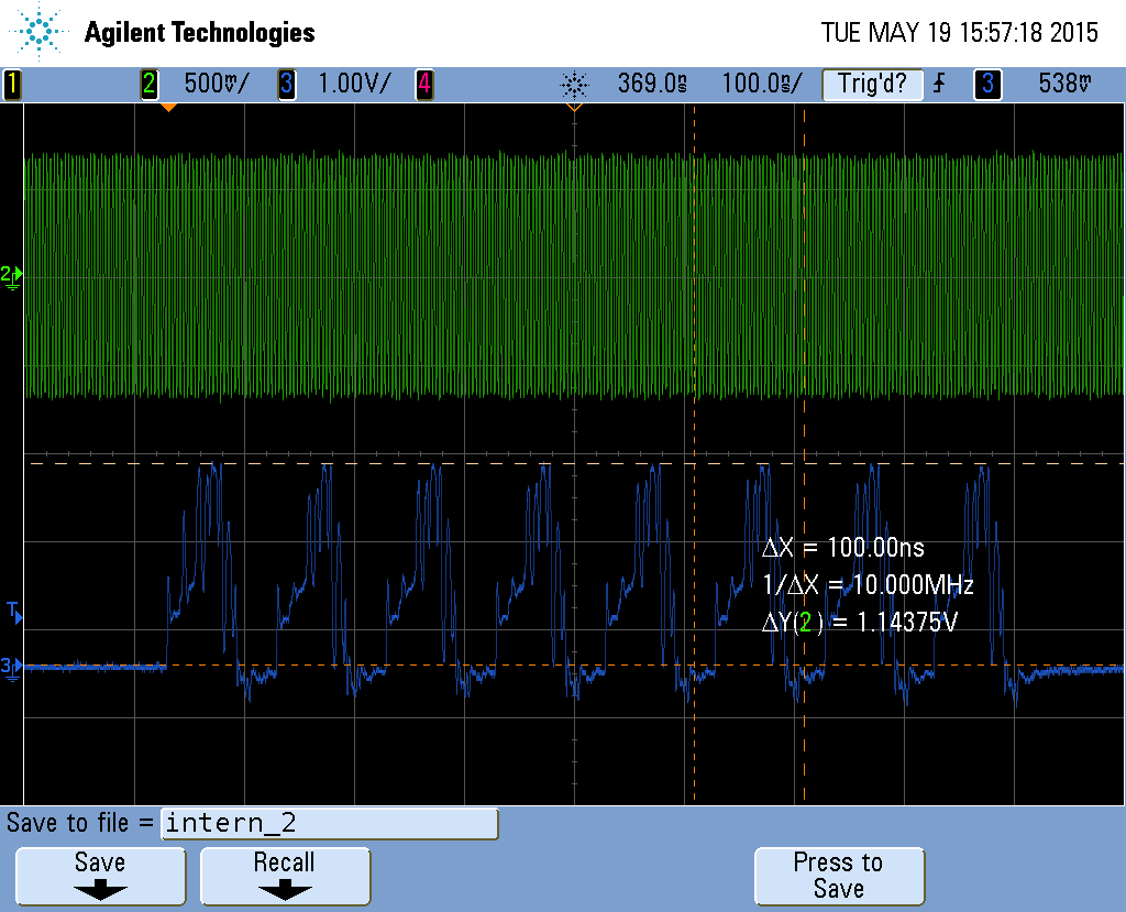

but the result i got is:

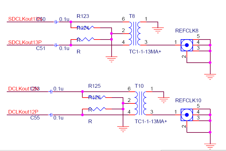

I don't think it's something about the configuration,and the circuit of the output is here:
I do need a steep rising edge of the pulse,so where do you think of the problem might be?Thank you!
