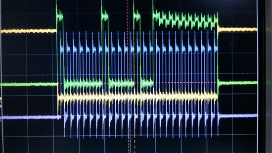

  • hello Timothy:
           I met a likely problems about the spi 3 wire reading.I am  using the LMK04828EVM , I want to config the lmk04828 with the outside FPGA borad  using 3 wire SPI interface. I do the  timing as you said, just like the datasheet. But it seems that  the read out data waveform  i captured by oscilloscope  is hign dependence? The captured wave form i paste below. Why there is no readback data?
    This problem has confusing me a week. Please help me, thanks!

  • Hello Nir,
    The readback should be able to be accomplished using a single transaction.  So after writing the R/W (as 1), W0/W1 (as 0), then the address, the state for your masters IO pin will change to either tri-state or pull-up.  Note that SDIO_RDBK_TYPE = 0 (pushpull) or 1 (open drain output -- requires external pull-up from PCB or master).
    To assist your debug, I suggest enabling one of the other pins for 4th wire readback so you can see the output data without the possible confusion of the master.  See attached.
