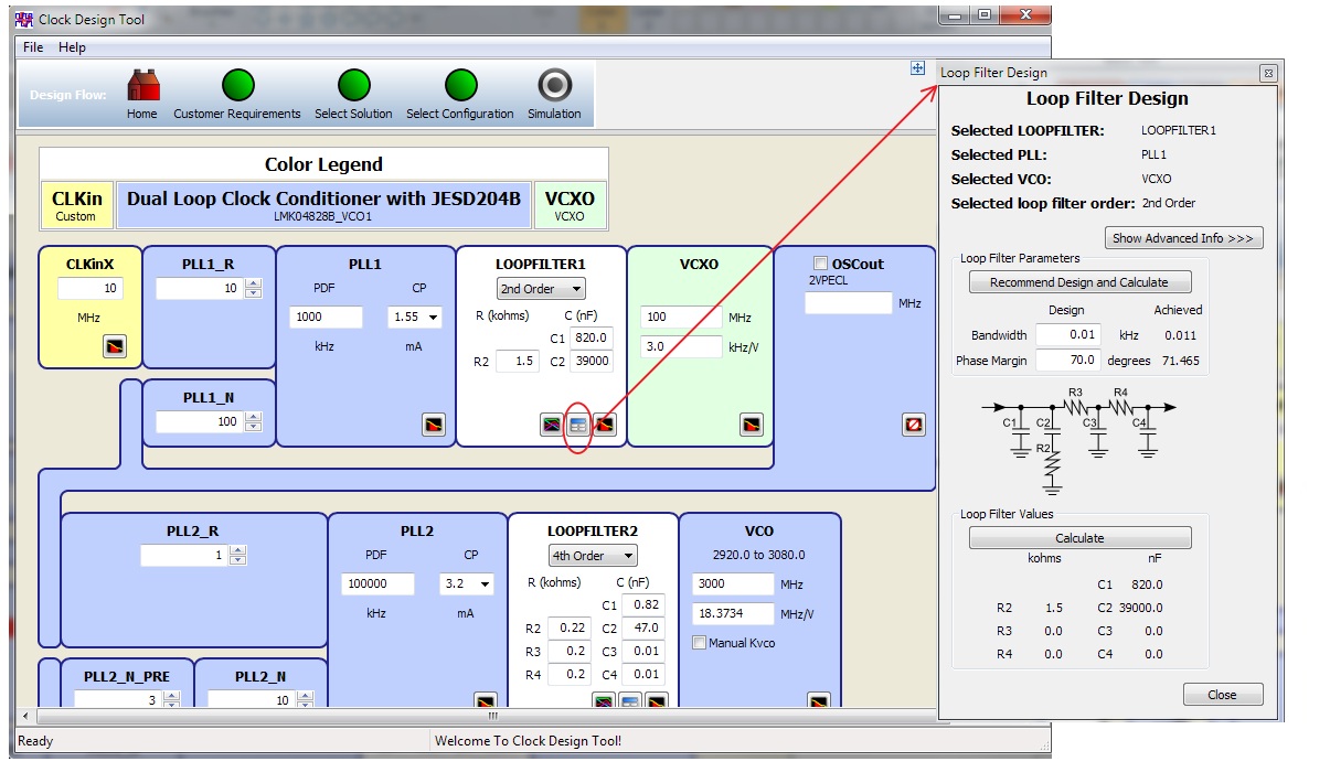

  • Hi Julian,
    Thank you for your replay.
    I have few more questions:
    1. What is best way to select charge pump1 external components schematic, and what is best way to calculate them?
    2. How to select optimal charge pump current?
    3. I am not able to get PLL 1 locked, I am using 10MHZ external reference with 100MHZ VCXO, R register set 10 and N register set 100. I am able to PLL1_N and PLL1_R outputs and they seems to be correct? Can you please advise what else I should check

  • Hello Iouri,
    1. you can use CDT http://www.ti.com/tool/clockdesigntool.
    It helps with loop filter design. In the Loop filter Design window, you can specify the requested Bandwidth and phase margin -> which will provide a good loop filter component selection.
    2. optimal CP current depends on the PFD update frequency and the loop filter components. I would recommend a CP of ~ 0.85mA and and PFD update frequency = 1MHz.
