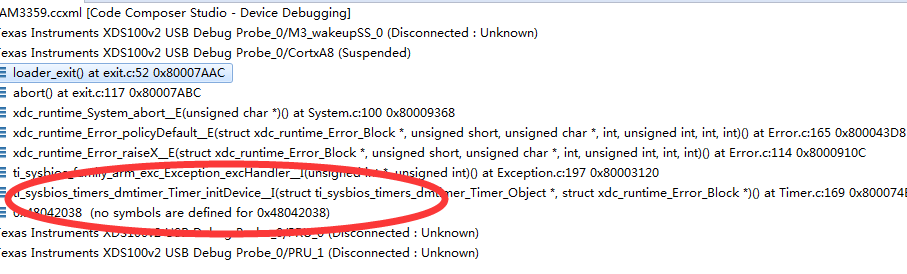

I am trying to use the timer  in sys/bios 6.41  at  ICE-AM3359,  but failed.
the err ,i met, is about as below:
just created a new project as following the sys/bios user guide :

build success and load the out file into the target.
but could not run the program
have tryed modify the timer id from "Timer_ANY" to 0,1,and so on , but also failed.   so bad  =.=!
CCS show me the same err point all the time
thanks to everyone who gives me any suggestions, i have no idea to debug and so dispirited.
